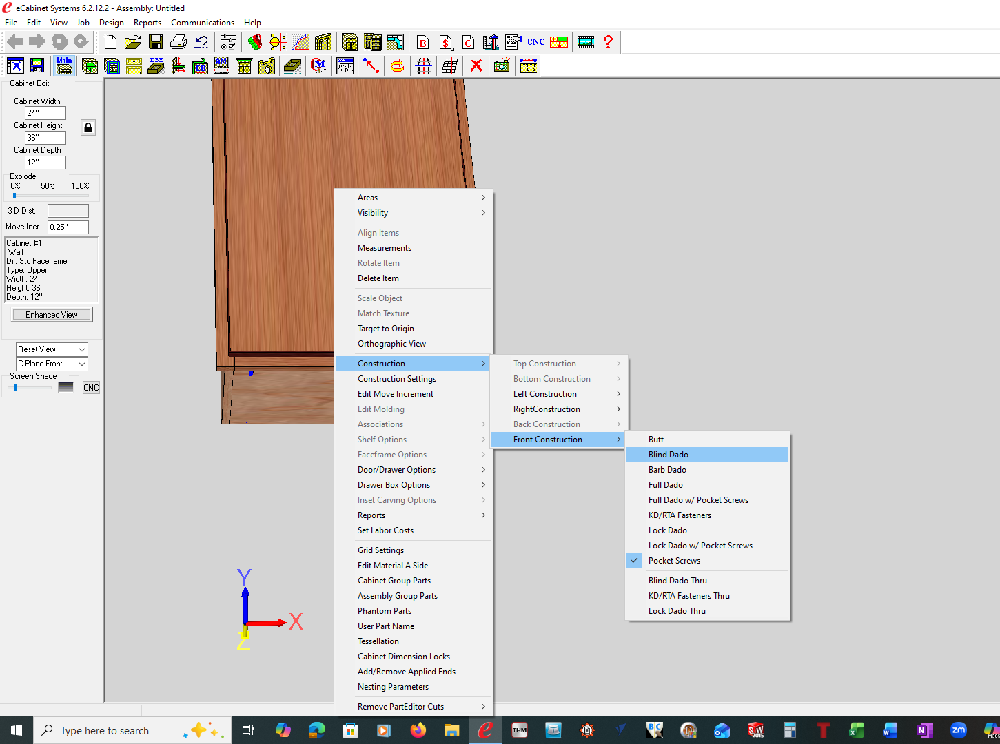

Never seen this discussed but we need the option to flip a tenon on one edge to the other side of the part. IE: on wall cab decks the tenon left and right needs to be on the top edge to remain captive but we need a tenon on the front for mounting frames to be on the bottom edge.
I think the most intuitive way to do this is might be in the construction popout tab have the option to flip the joint. "Front Edge, Blind dado (flip)"

Re: Flip tenon on one edge
That's one way for sure! I was envisioning doing it through the construction tab like shown. Wish I new how to draw in another little popout with the flip option.

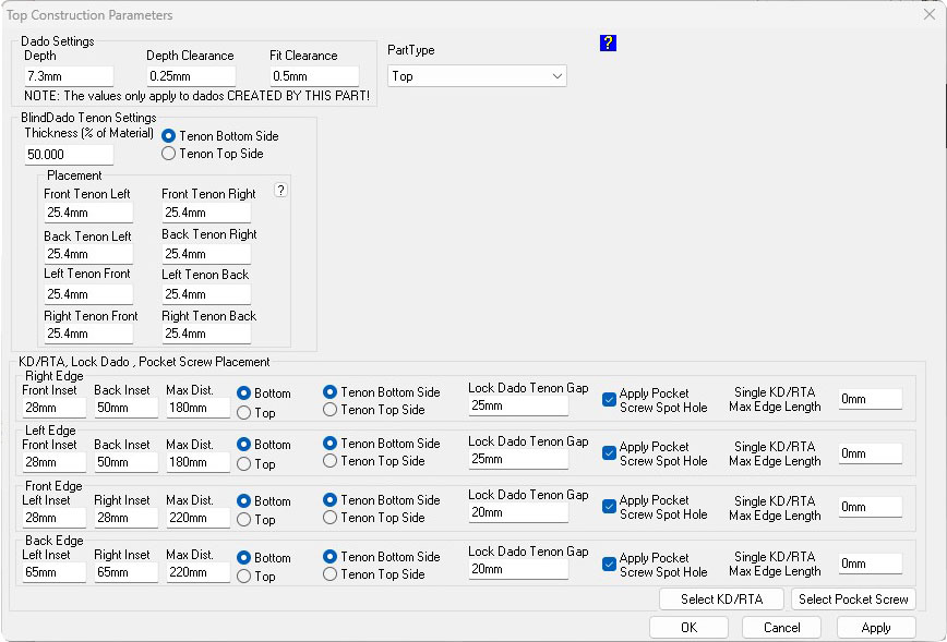

I never even thought to use the right mouse button to make that adjustment.
I have been accessing it through construction settings.
Your way is much faster for individual parts. Thank you.
