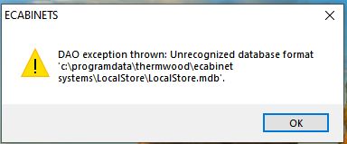

Had some problems with a hard drive and did the latest update, but now I can't seem to open the program. I gey this error message --

in your control panel, under Add/Remove Programs, find ecabinets.exe and choose the repair option

Wally,
These steps should get you:
1. Navigate to C:\ProgramData\Thermwood\eCabinet Systems\localstore.
2. Delete the LocalStore.mdb.
3. Locate the file LocalStore.6.0.ref.
4. Copy and paste the file.
5. Right click and rename the newly created file to LocalStore.mdb.
6. Start eCabinets.

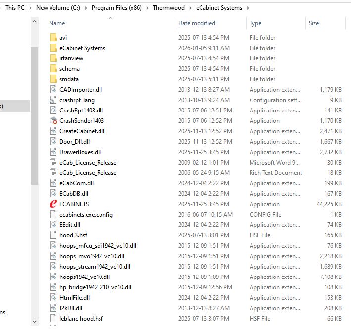

Thanks, Clint, but Localstore doesn't seem to be there.

you need to be in program data not program filesx86

Thanks, guys. I followed your instructions and then did a Repair, and it all came back.
