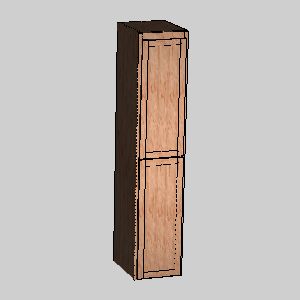

I don't know if it's me or something in eCabinets. I'm trying to inset the back of this cabinet .75" or the thickness of the top. For some reason, I can't make any adjustments to inset the back by the required amount.
Is there something I'm missing that is not allowing me to make the adjustment? TIA

The back inset is using a formula to inset it the Toe Kick Thickness. Choose the blue f(x) for the back inset of the back, choose the C to clear, choose Top Thickness. OK out of the menus, should be good to go.

I just ended up deleting the back, saving the cabinet, adding the back and then it would adjust for me. Not sure why it refused to adjust.

If a formula is in use in the Formula Editor, you cannot adjust the inset by typing in a number in the box.
