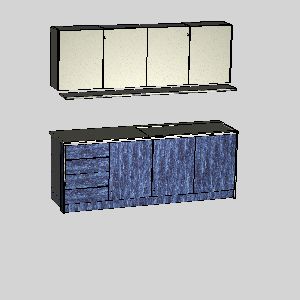

1] I put together this assembly called, 1 Tech Kitchen
I didn’t notice at this time that the drawers had lost the dados. I don’t have a drawer box without dados or KD holes in my library.
However I don't think drawers cause this problem. Its not at all rare for me to start chasing Kd holes around in assemblies
I nested the first assembly and It nests without errors.
Saved it for next time.

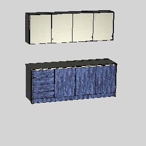

2} The customer wanted a few mods so i adjusted the top cabinets and copy pasted the bench top to make a light pelmet
I then noticed it was missing KD holes on the top cabinets. (Ive tried to recreate how they left the cabinet but at the moment cant do it.)
Thats the assembly called Tech Kitchen holes. I saved it to fix later on.
Also. Now if you do a nest, I now get edge banding has wrong body 2 times, which was not present in the original.
Its the doors on the 1174mm floor cabinet on the bottom right. I don’t know how that changed.
To fix that simply replace the doors.
How eve, when I return to the cabinet assembly editor the unit has now lost its KD holes, so 4 units without KD/ RTA
I individually select the units and replace the holes via the blue side buttons for KD /RTA's
Now it seems stable but you have to constantly be checking things, because just randomly it will be something else that plays up.
1Tech Kitchen.JPG (11.68 KiB) Viewed 88922 times

Tech Kitchen 2
2 Tech Kitchen Holes.JPG (12.37 KiB) Viewed 88918 times
