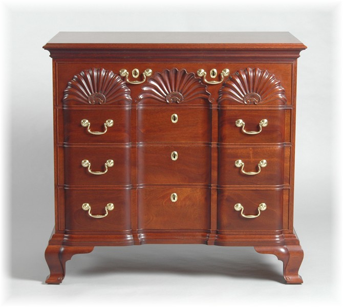

I don't think the Profile Modeler was intended to be used for joinery (mitered corners), that would be better cut by conventional methods, however the modeler says it uses tools from the group in the order you list them so if you need a big ball to remove material, put that tool at the front of the list and then use the 45 degree tool at the end to clean up. It will still take a lot more time than running the piece through a saw.
I want the modeler for decorative work, arches fluting and false panel cuts as well as relief carvings.
My ultimate use is for things like this block front chest.
My thoughts are that with the router I can glue up one big blank and cut this entire front as one piece then saw it into individual fronts then each front will be a perfect match. The base would also be modeled. I will have to find a way to do the feet as they can't be cut on a 43.

Hi Kerry.
Yes I see what you mean with metal drawers. Wouldn't look right on that period piece. I'm a bit focused on Euro style kitchens so my questions and wish list is focused in that direction.
The legs would be better on a 43 but thinking out of the box a bit if that leg was sliced up like a piece of cheese in say 2" slices so that out of one piece of timber it cuts 3 or 4 slices that you then glue together then sand the variations away would that work? I guess you'd couldn't have any undercut routing only face angles? I know at Atlanta 08 Thermwood had a 3D scanner that scanned a plaster mould of a human face. Could they scan a diced leg and give you that geomentry?
Shoot me down if this is too radical or impratical.

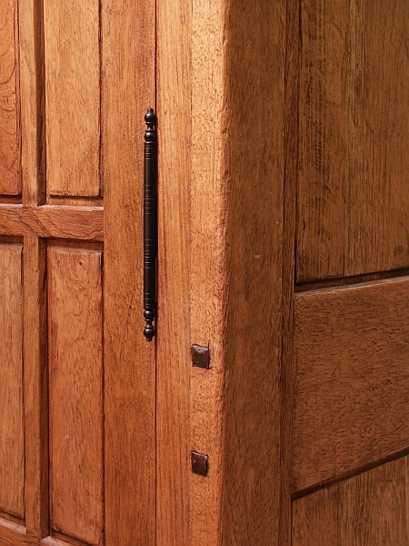

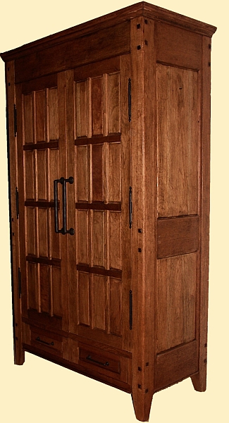

The furniture pieces are just for fun. Don't think I can make any money on them however the rustic furniture I have been doing like this armoire have been popular.
This one was made from Spanish Cedar but the next one I will use knotty alder. These are solid hardwoods throughout, mortise and tenon construction, distressed by hand.
I have been thinking about getting a real job and build furniture as a hobby. :D
