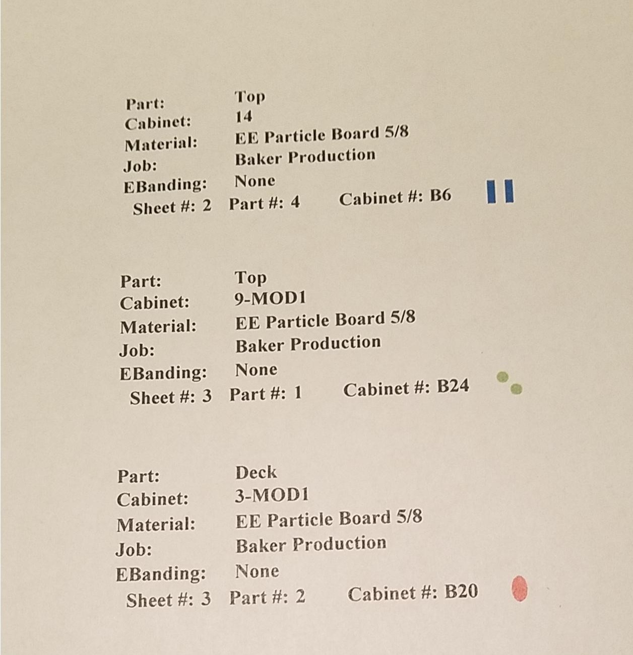

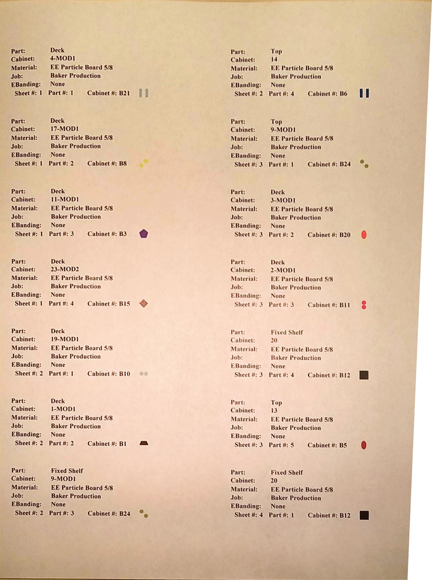

Clint,
The numbers would be perfect for us (as long as it uses numbers in sequence and doesn't pull random numbers like 1 then 205.
We use the 1p33X4_Address_Sheet report and there is not much room left, especially when we have banding diagrams. The number would basically have to replace the color symbols but that would still be great.

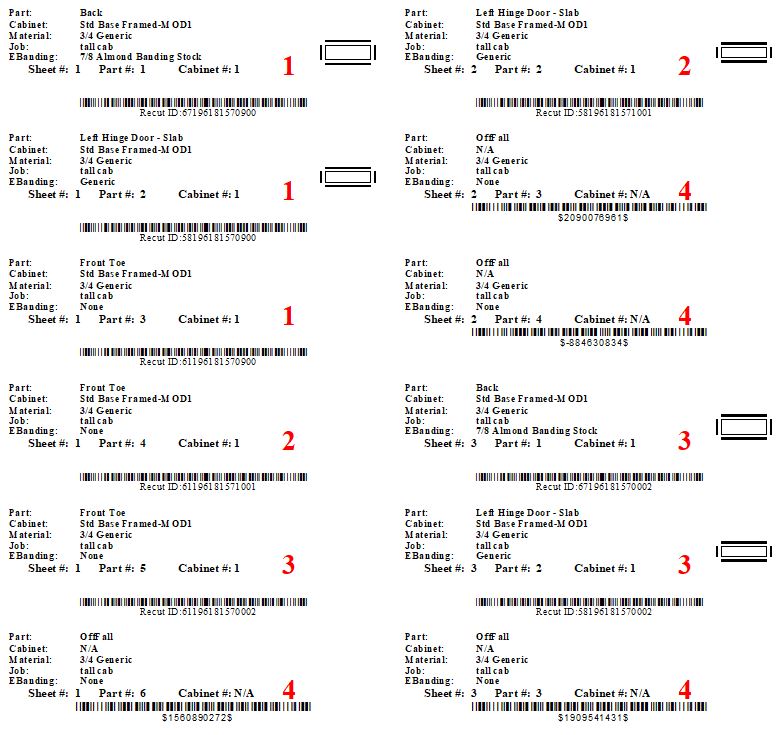

Kerry,
Thank you for the picture, the software for creating the labels is a bit tricky to work with so pictures of actual labels printed tends to be a must. As far as I can tell the numbers are sequential. I've tested with a batch job that had a cabinet and an assembly, and another job that was just one cabinet that I modified quantity to be six in Control Nesting. Both cases, each individual cabinet had its own number.
Do you want the number to be a certain color or just black? If so, what color do you want it to be?

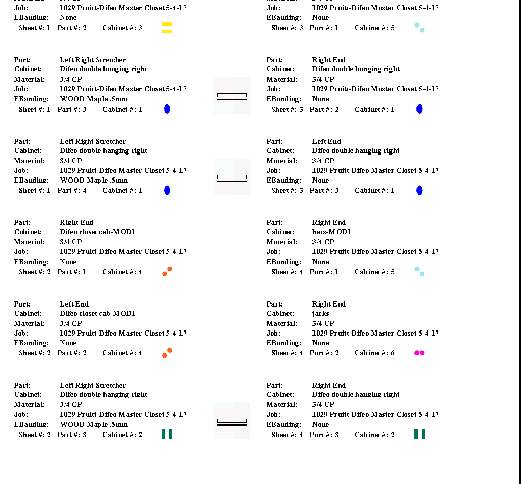

We are using the 1p33x4 labels as well. The numbers don't have to be as large as what you have in your example. Just replace the colored symble and make them as large as possible in the leftover area. They don't need to be colored. My only concern with using numbers instead of letters is that people may confuse them with cabinet numbers. But if numbers are all that can be done, they will still be infinitely better and less confusing than the colored symbols.

Attached are the two label files. Give them a test and let me know if they need to be adjusted. Seem to look OK on mine. I realized my mistake in thinking there was way more room at the bottom. Technically could go bigger on the number, but longer job names may interfere. The number shouldn't go any higher than the edgebanding material name line.
And yes, using an older version of Crystal Reports.

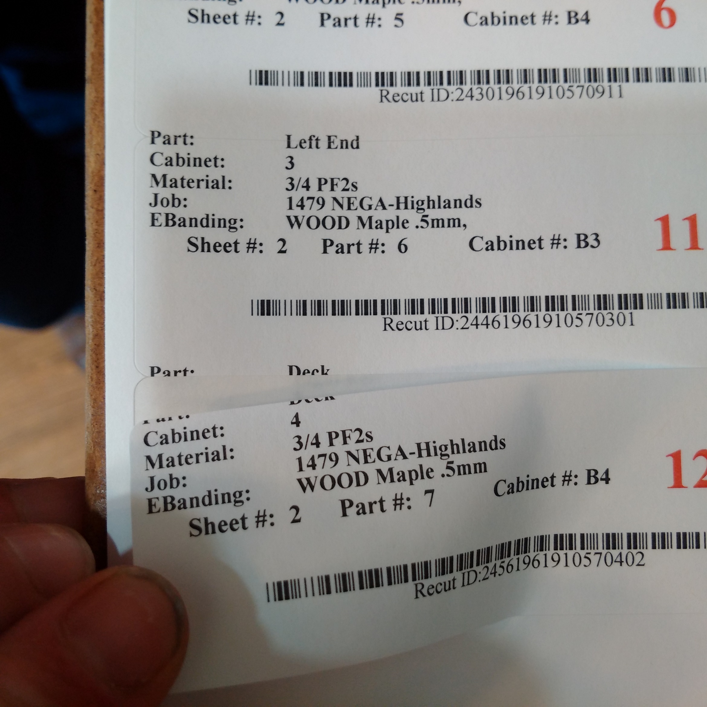

Got a small issue with the spacing between the labels. The further you go down the page, the more misaligned vertically the labels become.
CS-41 4x8
CS-45 5x12
