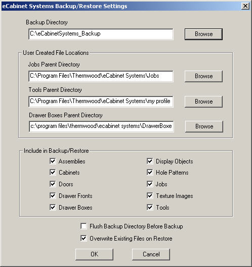

I sounds like you weren't backing up your jobs directory Tony. If the directory doesn't exist, it just isn't backed up...no error.
If you named your jobs directory \"Jobs\", this is what your backup/restore settigs should look like.
Flush means that all existing files in the backup directory are deleted before a backup is run. If you have files in the backup directory and nowhere else, flushing the directory will delete those files. Leaving it unchecked and \"Overwrite existing files\" checked will cause files with the same name will be overwritten and other files will be untouched.
If you uncheck \"Overwrite\", existing files with the same name will not be backed up.
