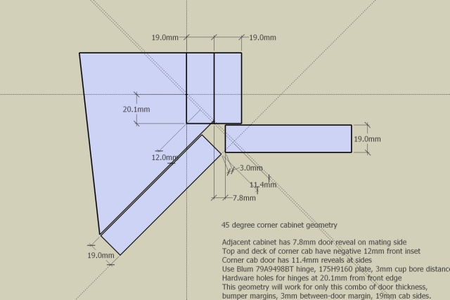

Jon,
Looks like you need to make the corner cabinet top and deck inset -12mm to achieve this. Notice the 12mm distance in the photo of the specs above. The door is at the front edge of the outside left and right end panels. The gap may be appropriate but the door needs to protrude out by 12mm.
Just an observation.

Michael Yeargain
Location: South East
Post by Michael Yeargain »
I found if you inset the left and right sides 19mm and provide the door settings with a 11.4mm reveal this will give the corner cabinet the proper settings as you have mentioned.
Now for the adjacent cabinet the door/drawer settings to the mating side of the corner cabinet should be 11.4mm.
This gave me a 5mm gap between the door and drawer. However you will need to tweek the cabinet a little to get this exactly where you want it. but it will work.
