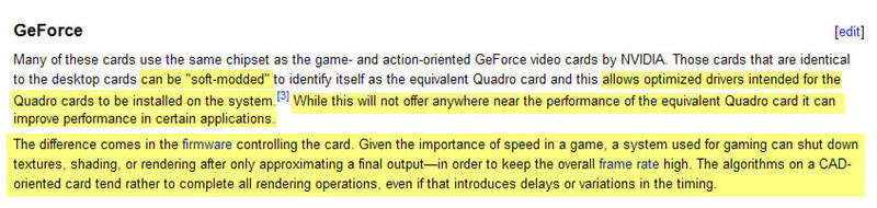

Nick M Singer wrote:Before i get an indignant reply to my previous post please refer to this link http://en.wikipedia.org/wiki/Nvidia_Quadro
<indignant reply>
Check the wiki article closely (highlighted areas) and you will see what I'm talking about Nick. A gaming card will never perform as well as a technical card in a technical application.
One thing to keep in mind about wiki articles is that they are NOT definitive sources of information as they can be edited by ANYONE.
</indignant reply>
By the way, just kidding with the <indignant reply> tags. :wink:

Come on Dan that is not the only source I can cite, at least be gentlemanly enough to admit they do use the same processors in the Quadro and GeForce cards as clearly outlined in the schedule. However this is all academic as what counts is user experience and I am stating categorically that for me there is no difference between the 2 cards I mentioned when running eCabs.... except the price. Others may feel differently however but a stopwatch does not lie.
Re: Planning new PC system - requirements?
Nick M Singer wrote:Come on Dan that is not the only source I can cite, at least be gentlemanly enough to admit they do use the same processors in the Quadro and GeForce cards as clearly outlined in the schedule. However this is all academic as what counts is user experience and I am stating categorically that for me there is no difference between the 2 cards I mentioned when running eCabs.... except the price. Others may feel differently however but a stopwatch does not lie.
<gentleman=on> :joker:
Okay, I agree that they appear to be using the same chip. The biggie is the firmware though. This is really where all of any chip's capabilities come from. Without firmware a chip is about as good as a handful of sand and the driver cannot communicate with it.
You are correct though in that whatever the user is happy with is what counts.
Now, head down to Clifton 4th...it'll take your mind off of this. :beer:
