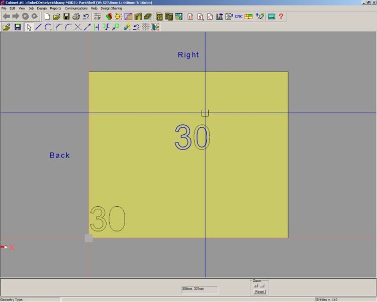

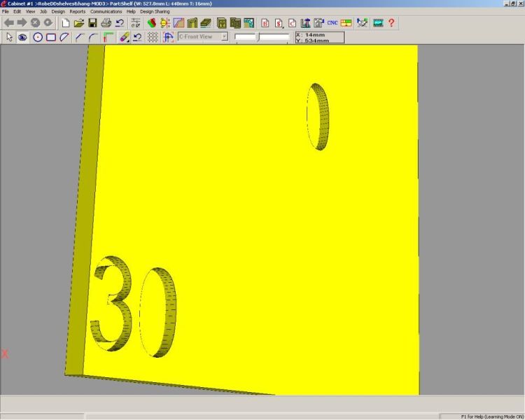

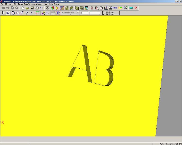

To clarify the problem with DXFs in PE its the old numbers/letters problem again cant get them to come into the PE from Turbo Cad even though other shapes do. Another thing that needs to be looked at is continuity of key strokes across the app. eg. Ctrl/arrow pans in floor layout but not in PE etc.

Here is an example of the number / letter problem. I know why it happens but fixing it would sure increase the versatility of the program, depending on how it machines of course. had lots of trouble with cutter compensation in the past.
