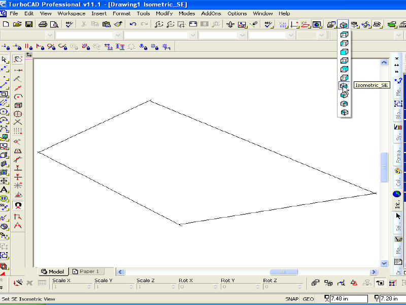

In TurboCad trun it to Isometric then trun it into a solid see if it will do it

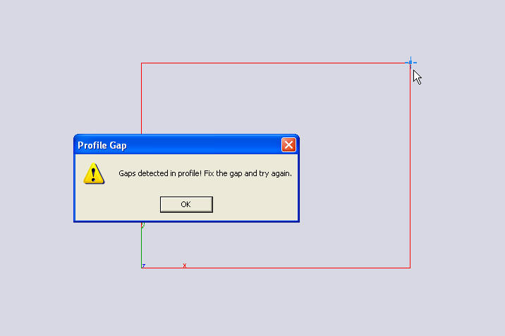

I use ViaCad it will show me the lines at do not close
Dan's Video is very good that helped me alot
http://www.ecabworld.com/Media/Video/Cr ... Panel.html
Via Cad.jpg (25.14 KiB) Viewed 3480 times
