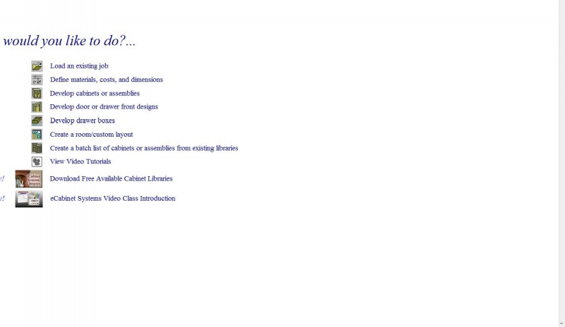

When I use the camara i will get the oppening page of eCabinet. Please see image I had to use print screen to do this.
