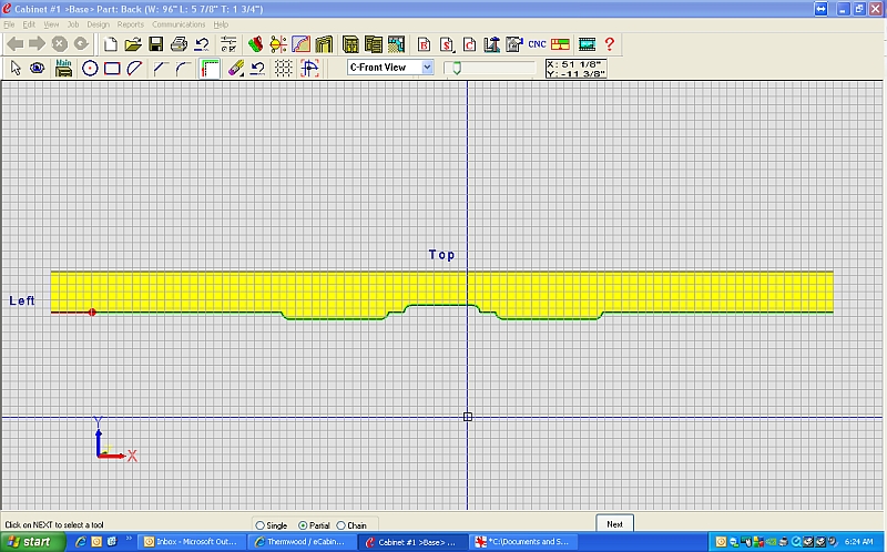

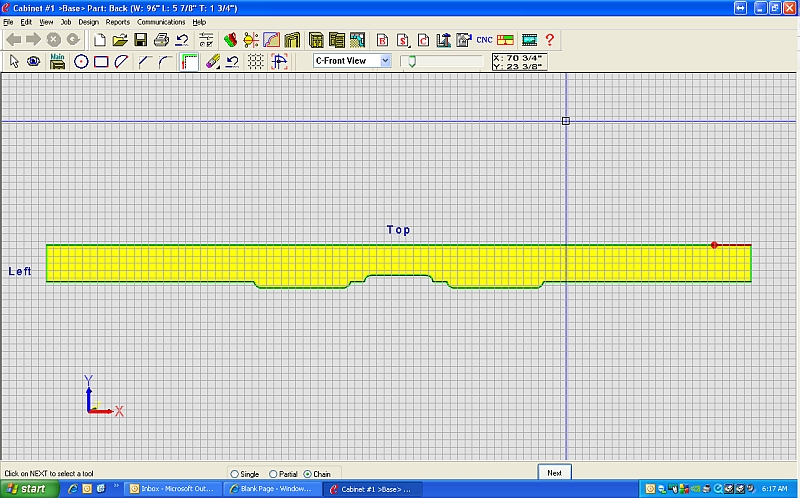

I am using the part named Base created from a beck
Here is the starting point and direction for a chain which works for me
and here is the starting point and direction fro the partial which does not work
