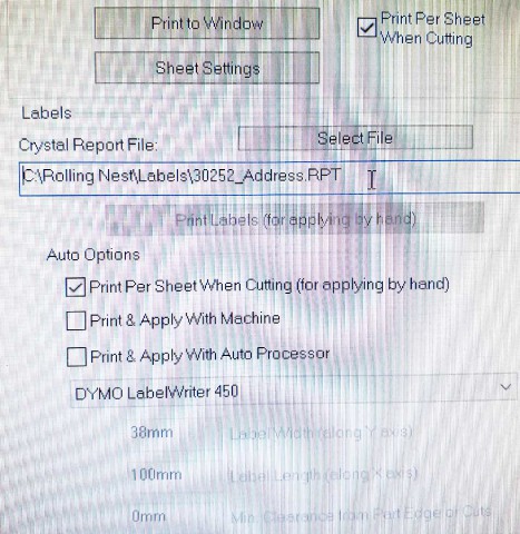

I tried using this label and hit print and then it tried to print 5000 pages with the numbers flying up before I stopped it. any idea on how to trouble shoot? im using a dynmo 450

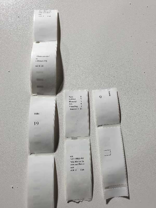

I also tried the new format with the attached result.
Like Thomas the printer started running like crazy and we had to hit the kill switch.
Also using Dymo 450, model 1750.
I tried changing to portrait in settings and it didn't affect the results.

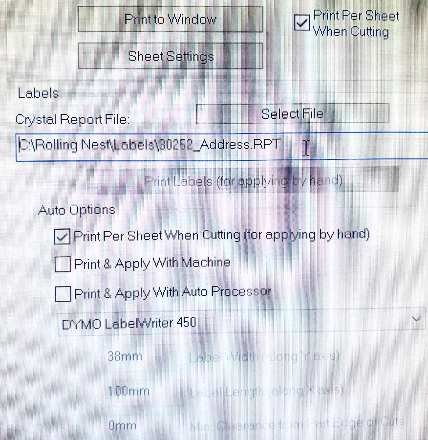

I happened to take a photo of the previous settings of the file we were using before we changed them to Clints new one. (just in case....) :?

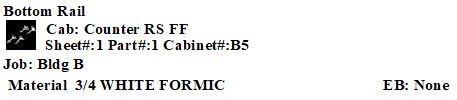

If someone wants to post a picture for a good location for the number, it would be worth discussion. The Symbol version of the 30252 label places the picture is shown in the attached picture.

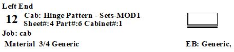

Thoughts on this label?
Jeremy Schiffer
Posts: 1168
Location: Carnesville, GA
Re: Colored symbols on labels
Post by Jeremy Schiffer »
Clint Buechlein wrote:Thoughts on this label?
Looks great to me! You may have run out of room for more than one edgebanding type, though.

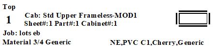

Well that was a small can of worms. It should have worked fine as the text is just right justified so it should have built from the right side inwards, but something is wrong with the field. I put banding on four sides of a part, but it would only ever display two. That was using the symbol label is my starting point. Using the standard 30252 Address label, all is well. So I shifted over the two lines and added the field.
Appears to be working now. I need someone to test it though in the event my tests are insufficient.
New Label.JPG (18.09 KiB) Viewed 40070 times
