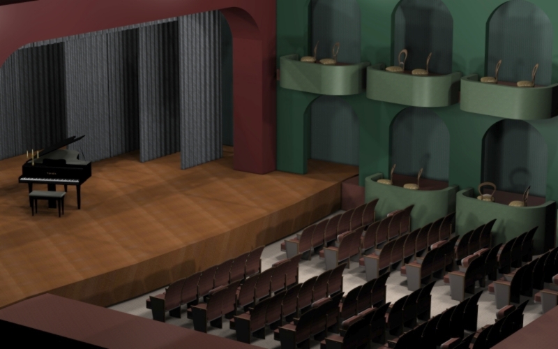

The performance isn't too "abysmal". I was able to add all the seating and now I am gong to start on the wood work.
I think one reason this job is such a monster is that there are 24 light sources to calculate.

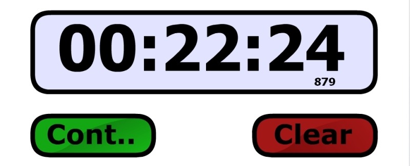

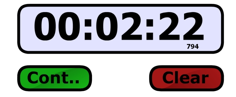

My system is shown at the bottom of this post. It is about two years old and I am curious if the newer stuff isn't working better.
It took 2minutes 22 seconds to load the file and then without moving anything it only took 6 seconds to render the overhead view but then took 22 minutes 24 seconds to render a presentation view. Movement is jerky but not painful.
I think that another thing with this file is all the curved part editor cuts. There are hundreds of them on the curtains.
I would like to know what the Ultimate eCabinets Machine might be. I have never been able to do all the stuff I want to job files because the computer balks.
Time to open the Stage File
load time.jpg (71.48 KiB) Viewed 8815 times
Presentation View Render Time

Ok Kerry as you can see from my earlier post my Quadro 3500 system is now back in business and I can report that the performance is just as awful. I only get a black screen when I try to do a presentation view and the handling is slow and jerky. It appears to me that the performance on your system is about as bad, I would find it unacceptable and impractical to work on a job that handled that way, 22 minutes to render and image, please spare me! we may as well draw it by hand. I can only conclude that the money spent on a Quadro is simply not worth it and that for the average kitchen design a good gamers card works just as, or about as well
