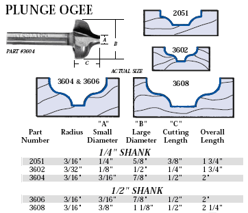

Would anyone happen to have a .tol file for this Whiteside #3606?
Thanks!

There is one close in the part editor ( whiteside tool profiles) .But you are probaly going to have to make the tool yourself.
Re: Whiteside 3606
Post by Gary Puckett »
I hope when V6 does show up , they made drawing a tool a lot easier. I have been trying to create this tool for a member and having no luck.Their is a broken line someware and I can't find it. Here is the profile the number is 3606
OH I did not use a spline, I used two 3/16 Rad.

Gary,
Send me your x_t file of the tool you are trying to create with the broken line. I'll see if I can fix it.
