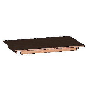

Here is the top with an apron, just add legs. You can look around on the construction to see how it was done. The front apron is a stretcher, it might be problematic when resizing the depth.
Table w apron.jpg (6.46 KiB) Viewed 13790 times
Table w apron.hsf
(874.02 KiB) Downloaded 914 times

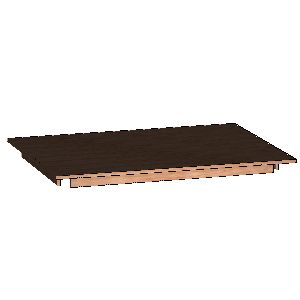

Joe, if you need to resize Leo's table and still have it keep it settings the front stretcher needs to have some of its settings locked.
I attached the file with a couple of the stretcher settings locked.
-John
Table w apron 2.hsf
(876.02 KiB) Downloaded 922 times
Table w apron 2.jpg (6.32 KiB) Viewed 13736 times

Joe Harkin wrote:Leo & John:
:?: TUVM both for the tabletop HSF. Not to be a PITA, but don't I need a mstching JPEG file to use it? :?
To use it all you have to do is download it. When you save it with a different name it will generate its own jpg.
