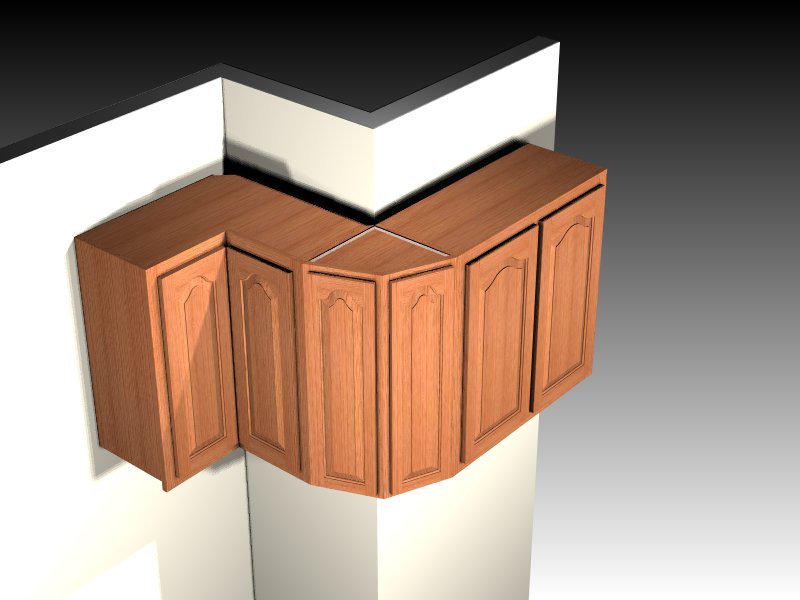

I am having trouble figuring out how to design an end corner cabinet with 2 doors angling to the center. I have built them before on the table saw but that isn't much help. here is an example http://www.kitchensonclearance.com/imag ... binets.jpg

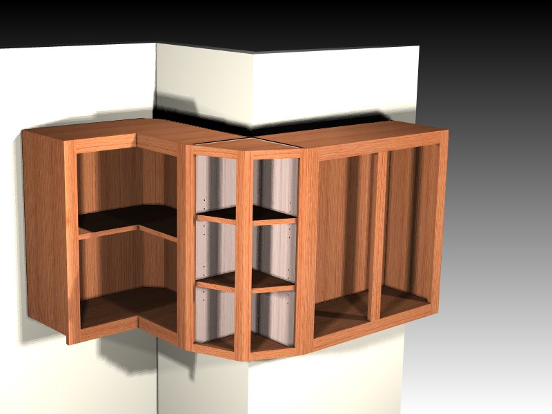

Corner Cabinet_11-9-09.jpg (51.55 KiB) Viewed 17383 times
Corner Cabinet_NO Doors_11-9-09.jpg (55.71 KiB) Viewed 17383 times

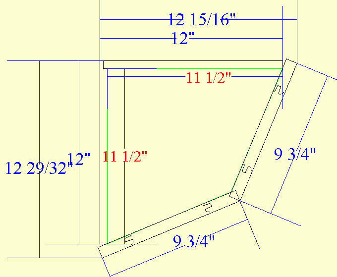

I am trying to build a frameless cabinet like the dxf file shown. I tried to use the ecabs one that you provided but I can't figure out how to remove the other 2 cabinets. I must be missing some trick, but I can't find the info in my Ecabs guide.

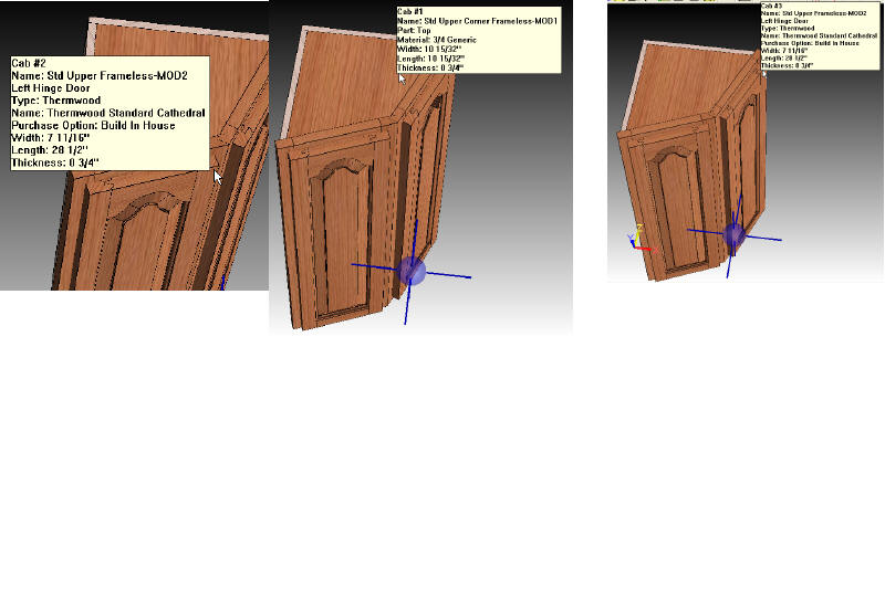

Now more problems. When I delete the doors and frames and try change materials and dimensions/insets it reverts to a square again. Do I have to change this in part editor??

Sitting here or the last few hours with ecabinets guide and still can't figure out how to make this cabinet. I can take a frameless corner cabinet, change all the material to 5/8 but can't get the angled fronts on it. :?: Any ideas what I should do at this point?? I want to make a 12"wide by 12" deep with no face frames but with doors. :wall:

I need it to cut, as well as to get my door sizes for ordering. it is on the end of a run of 12" deep by 40" tall uppers. All it needs is a left side and a back as well as 3 shelves. the doors will cover the front.

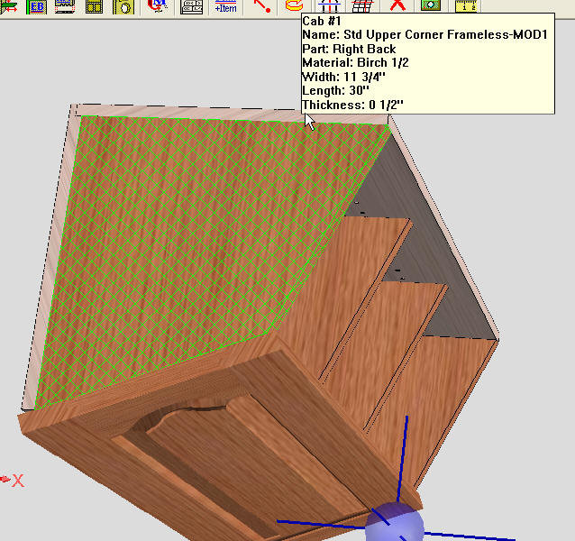

Lorin, I am having trouble making it work too. I took a normal upper frameless cabinet and resized it to 12 inches wide. Next I deleted one side. Then highlight the top and take it to the part editor. Go to contour mode in part editor and you can draw the geometry there. Then get back out of contour mode into regular part editor and your geometry will still be there. Select your geometry and right click to open the option box. Select cut pocet using closed contoru and select cut through.
This will cut out whatever geometry you have selected.
Now for my trouble with it.
I can't seem to make my geometry into a closed coutour. It will not cut anything unless it is closed.
If someone will chime in and fill me in on how make the lines into a closed contour I think I can get you there.
Then you will have to take the bottom, top, and all shelves to make the same cuts on them.

Here is my corner frameless cabinet
In a Zip file with 2-DXF Top and Deck
