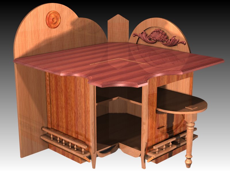

Corner Cabinet
Corner Cabinet
Corner Cab.jpg (74.31 KiB) Viewed 138067 times

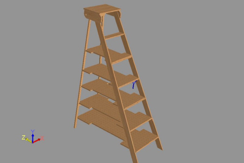

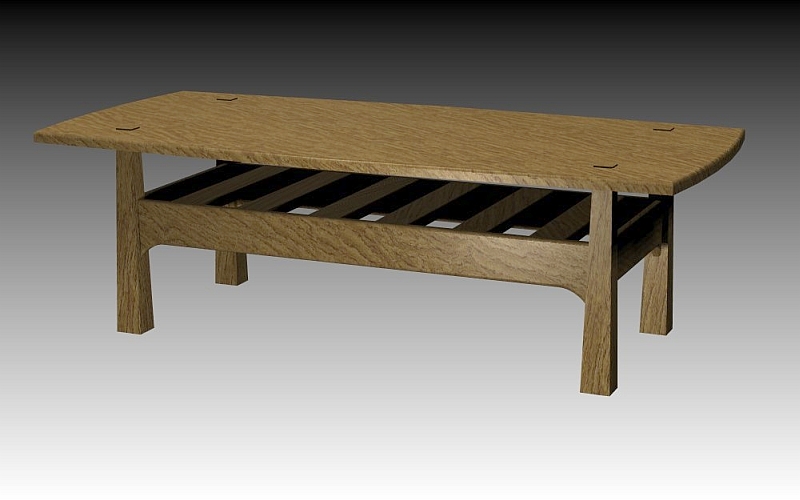

Don't get frustrated, hang in there you can do just about anything with this program. Just think on how you would build it and draw it the same way. Insted of buying the boards you create them.
This project was drawn that way.
Re: Dont throw the drafting table away just yet!
Kerry I like your table
