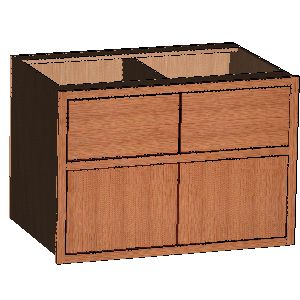

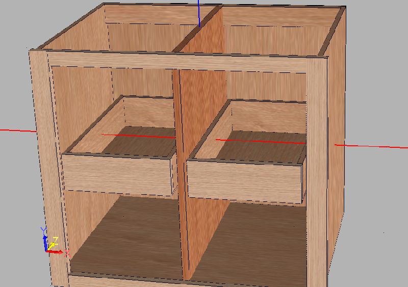

John,
Is this what you are trying to do? If so, I just placed the drawers in drawer box editor.
Sample Cab..jpg (51.05 KiB) Viewed 17001 times
Sample Cab2.jpg (67.19 KiB) Viewed 17001 times

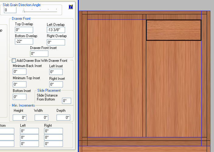

John,
Here is another one I did with placing two display boards as drawer fronts.
Sample Cab 3.jpg (66.67 KiB) Viewed 16995 times
You can take it to part editor to put an edge on it if you want.
John

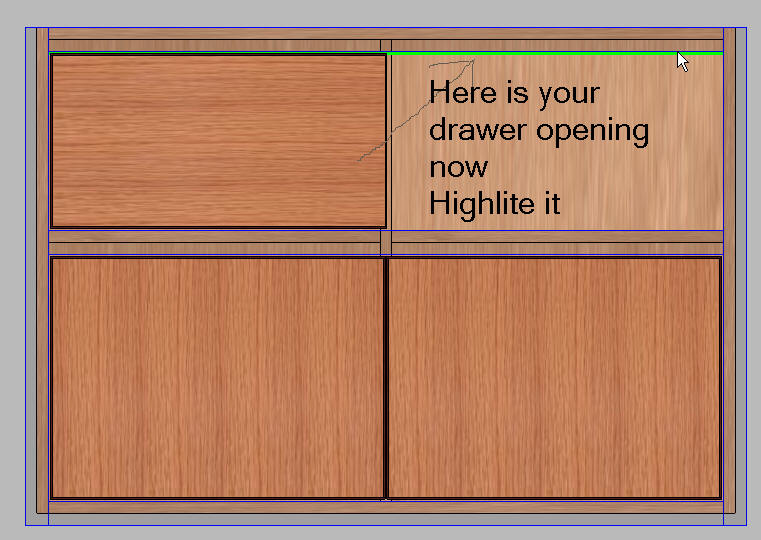

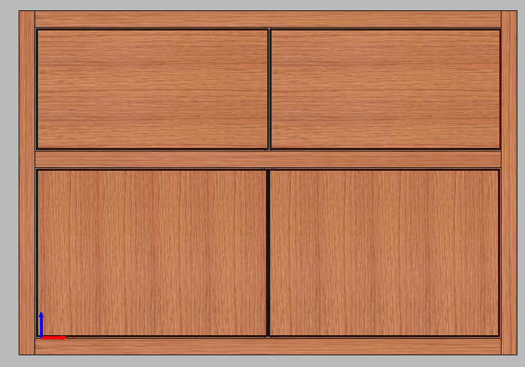

Re: placing 2 drawer fronts in wide cabinet w/ partition
John, if you hilite the opening and add a mid stile, you can then add two separate fronts. Adjust your mid stile to 1/32" in width, and adjust your gaps for correct clearance and it should show properly. Note: Make your Mid Stile from a different material like DNC so it doesn't confuse your cut-list. Also watch your Drawer box side clearances. HTH.

Rick, I considered this and will try it now, sure enough it works, I will need to try the same thing with a euro style cabinet.
Thank you, John Vickerman
