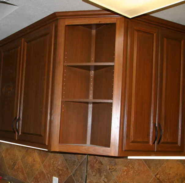

I did a cabinet similar to what you are describing. I used my CAD program to design it then used my 3D carving software to layout the parts on a 4x8 sheet of material and cut them that way. It seemed to work well.

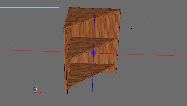

Thanks for the replies. I think I figured out how to fake it into doing it. Created a sheet stock of 0.002" thick. Took a base cabeint and made teh right end the thin sheet and the rest of it 3/4" material. Took the right back and made it back flush and took the right end and made it front inset 23.247", leaving a .003 x .002 piece of side. Then I angled the top, deck and toe. When we assemble it, we can deal with the .002 x .003 flat on the tapered end. Looks OK in eCabs so I am giving it a try. I can filter out the right side when I cut. Am going to try to cut it Saturday.

Worked out. I had to create a material of 0.002" thickness for right end and will have to cut in a toe kick on right back but otherwise all good.
