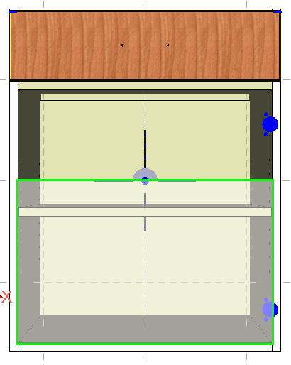

Take the attached cabinet into the door editor, remove the door and try to select the opening where the door was. Clicking toward the top of the opening doesn't select anything. Clicking toward the bottom of the opening, selects part of the opening.

I added a door (that appeared displaced), deleted it, and was able to select the opening correctly. Not clear on why the issue would occur originally, though.

Now when I add a 605mm tall door, it creates a door the full height of the cabinet, covering the drawer front...
