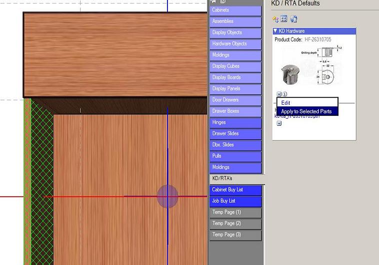

I seem to be having trouble with my buy list. I have hinges with costs etc. applied to my new cabinet but when I pull up my buy list it shows nothing about hinges in my buy list? Not sure why I can't get anything to show up? Would like to be able to consider pricing everything in ecabs soon!

go to the kd/rta tab, select your kd parts. then Select Apply to Selected Parts. Then run buy list.

Thanks for that info on the buy list. I was having problems applying to the cabinet I guess. It was not until I went into change applied hardware per part that I was able to change my hole pattern though. I understood that you could add hole patterns without hardware but thought that hole patterns would still be associated to hardware fitting. Gonna take some getting used to but I think I can see the benefits of this new system!
