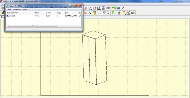

Here is an example.
I loaded the program went to the cabinet editor and opened the cabinet took it to the LDE and printed.
I didn't print, by the way.
Just the cabinet you see

Guys here is a thought... It looks like with the new version of eCabs the printer output is changed to a vector format. I just did an experiment and the printers resolution setting is directly tied to the spooler file size. My guess is the spooler is just barfing at some point as it grows in size. I'm on XP so I don't know exactly how vista and 7 react. But if possible, go into your printers resolution setting and set it WAY down. Go as low as you can and see if this helps. I did a simple cab out of LDE... at 300 dpi printer setting, I got a 41mb spooler file. At 3600 dpi printer setting, I got a 120MB spooler file size. Drivers are very sensative to how windows GDI dumps the print file to them. Make sure you have up to date print drivers and try to set them way down in resolution.
