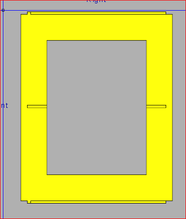

Open the attached cabinet derived from V6 std base framed. The top dado settings are set to 1 1/2" on the R & L fronts, but they show as 1". If set at 2" all seems fine. When the top is taken into the PE for a closer look it returns a "funky" little geometric quirk between 1" and 1 1/2" on the tenon dado.
Top Settings.PNG (6.67 KiB) Viewed 4338 times
The nest shows a similar error.

Another note.....
The Nest shows this as a pocket with a depth of .5"

Gary,
I removed the PE cut from the top and added it back on and cannot reproduce this. Could you please give me some steps to reproduce this issue. At this point this does not look like a V6b2 issue, just maybe a scenario that you may have found. Anyway, if you can give me some steps, that would be great. Much appreciated...

Scott...
In V5.2, virtually all of my base cabs has this "web Top" some have had the blind dado joinery for the partition. None have had the PE cuts to the partition shown in another post. None have shown this error. It may be a product of changing the Dado front stops last or the combination of PE cuts that caused it.
I also found that removing PE cuts from top & partition resulted in I cannot reproduce on my machine.
I can forget about this until its repeatable.

Post by Scott G Vaal »
Thanks for the reply Gary. I tried changing the insets for the dados after the PE cuts and it still is working OK. Just let me know if you run across it again. Thanks for the feedback.
