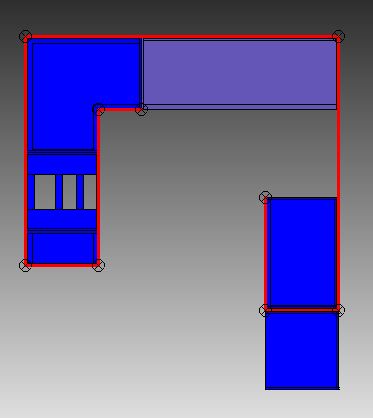

I am trying to do a bench top layout which has an assembly in it. The asembly has external actine points but no internals.
Is there any way to add your own active points?
Benchtop Layout problem..JPG (19.98 KiB) Viewed 3712 times
I think one solution would be to create a big benchtop material in the CE and take it to the part editor.
But I was just wondering if I had missed some aditional controls
Any ideas apriciated

Mark,
If you are trying to make a top that spans the open space I would place a cabinet to fill the space and give you nodes for the top and after the top is created delete the cabinet.

You know Kerry, i hope you never run out of these tricks you seem to keep pulling out of your hat!!!!
Thank you
