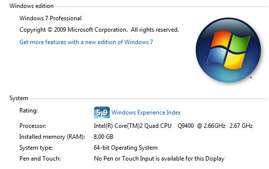

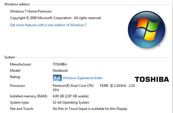

Hi Kerry
Very nice Job.
I tried it on 2 computers; the laptop was slow and jerky but was okay. But at the upper limits of its capacity
Laptop
Laptop
The desktop worked fine, and had enough space to add some more detail.
Out of curiosity. How long would this presentation take you to do if your system was working normally? And would you have to do any more adjustment work to it to prepare it for the workshop?

Re: Help with Graphics Card
Hi Kerry.
Thanks for the reply.
20 -30 hours is very good for that level of presentation. Its always good to have a benchmark to work towards.
Again on your drawing. On the laptop it does need a bit of work to left click and drag. But it’s usable.
The desktop is a lot better but I still wouldn't say it is working brilliantly.
A funny thing. Your drawing saved to a new file on the laptop but on the desktop although I tried a few times it came back with some kind of hoops error and would not let me save it.
Also I was surprised to see your bench tops rendered. I am working on a job at the moment but the bench tops don’t show up in the rendering. Is there a trick to anchoring them?
