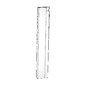

Michael, it depends on what kind of process you are considering doing. We design closets using 2 different methods.
Component Parts:
This way is more standard. We have always cut our parts with an itemized cut sheet for parts. Since we have the cnc now, we have created extensive component parts libraries (with the help of Jody Wilmes to get us started). We simply design a 2d cad elevation view for our customers and then create a batch list for our cut list. Now with this process, we are using the rigid 32mm system with full line bores. Each vertical/ partition has the double line bore and a notch for the hanging rail along with 2 5mm holes near the notch for the suspension bracket to secure the vertical to the rail. My libraries consist of different depths and within those libraries there are different vertical/ partition sizes, along with fixed and adjustable shelves of various widths so as to be able to quickly create the batch list.
The holes in the verticals/ partitions are each constrained together in order to be able to resize them.
Closet Cabinets:
This is a more custom way of doing things. For those customers who don't like all the holes, I build cabinets with or without a backer. I have patterns to apply to the partitions to create the notch for the rail. I have yet to create full libraries of closet cabinets because we are still feeling our way through this.
When I create a wall of closet sections, I tend to create it with one cabinet with a various number of center partitions to divide up the space. I have found this to work very well.
I am attaching a partition from the component libraries as well as a cabinet from a recent job we have done.
I'd be happy to discuss this further with you if you have any further questions or if I didn't give a clear answer.
-John
