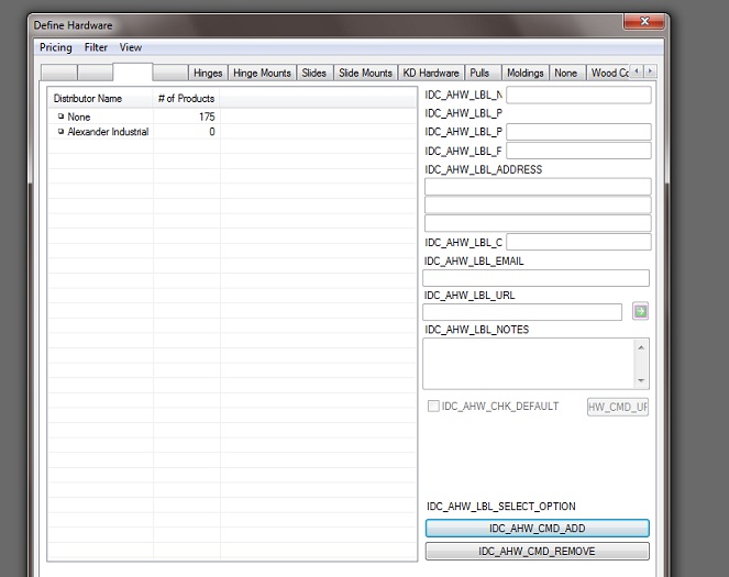

Hi -I have upgraded from v5 to v6 build 4 by doing a fresh install and copying certain files across . Am using Windows 7 64 bit .
Certain windows are displaying strangely , especially in the hardware section . Screengrab below (hopefully). Am I missing something ???
Thanks in Advance
Matt

Looks like you over wrote the stringtable.mdb. You need to rerun the installer and choose the repair option.
