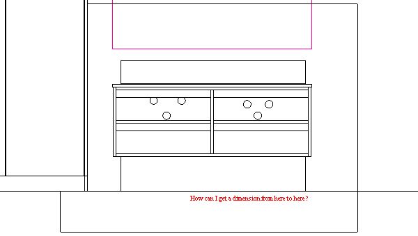

I can't dimension from a node on anything (cabinet, wall, assembly) to a wall item (ie: water pipe). Is it possible to do this, or am I having bugses? I need to find the dimension from a water pipe to the inside of a cabinet, so I can design the drawer to fit around it.
Thanks - Jason
P.s. great - the jpg doesn't show the leader with arrows pointing to the side of cabinet and water pipe. I suppose that's for another post....

This is not a bug. Markers for those items just never have been implemented. The only "Wall Items" that show markers in the Line Drawing Editor are Doors and Windows. I will put this on the wish list for future implementation. For now, you can add a Display Cube on the wall to represent your water pipe, etc. The display cube will show the corner markers for you to dimension off of. Hope this helps.
