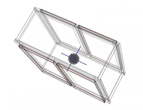

Here is one way that I do it.
I make up the cab. that I want then copy it then just us the face frame and doors on the back of the first cab.

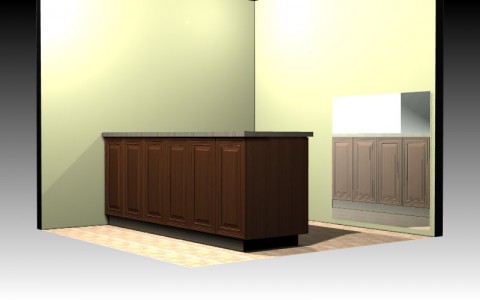

Here are some base cabs I did with doors on the back. The "Front Cab" has no back, and the "Back Cab" also has no back and the depth is set at 1/32". In CL, place the cab then rotate it.
