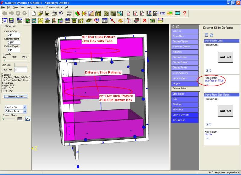

I went in and changed the default in the DBE and also the DDE to the same hole pattern that I want to change the current too. Then I changed the hole pattern in the CE and applied it to the cabinet and only the DB with a face changed. The 2 pull out drawers added in the DBE stayed the same. Note the screen shot.
Can you check out this cabinet and see if you get the same results?

John,
It works fine for me with your cabinet.
Here's what I did:
(with nothing selected)
First went to the item window and clicked on "drawer slides"
With the little arrow pull-down, select EDIT and choose the new pattern.
Double arrow twisty looking pull down thingie at the top, apply to cabinet.
This only affected the drawers which were added in the door and drawer editor. (the top drawer only)
Next I went to the item window and clicked on "dbx slides" and repeated the process.
Once I click "Apply to cabinet" I have a new pattern for the drawer boxes that were added in the drawer box editor. (the bottom drawers)
jnr

Hi Josh! Thanks for taking a look at this. I see what the problem is. I was trying to change the dbx slides by changing the drawer slides. I didn't realize that there was a difference between the drawer and drawer box defaults :oops:.
