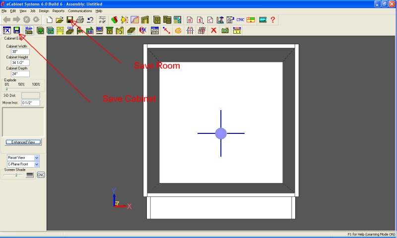

Re: Cannot open ESJ file
Bob,
It sounds like you used the wrong Save Icon.
If you didn't place the cabinet in a room or open it in batch and used the black save icon on the top row of buttons, you just saved an empty room.
Your cabinet would save as an .hsf file using the Blue Save icon in the cabinet editor.
