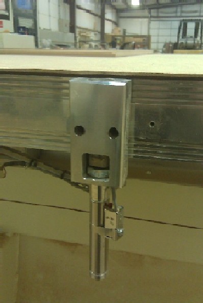

Josh, here is what we did with our pins. The pistons are reused but an aluminum block was milled with a titanium pin to very close tolerance allowing for no wiggle room. My uncle is a machinist and made the items for us.
Forrest
