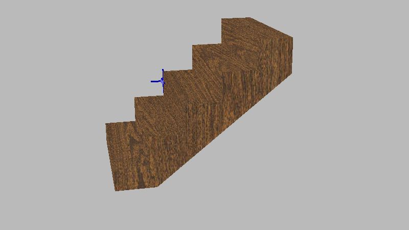

Re: Need to draw steps
Gary, could you once again use the cabient as a building block for everything and make the bottom step a 36" wide x 6" tall x 8"deep cabinet, then 2nd step be a 36 x 12 x 8, 3rd step is 36 x 18 x 8, and so on, stacking them up to build a stairway?
Just a thought.
Rob
Just a thought.
Rob

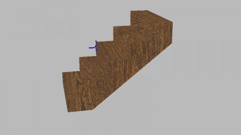

Use a display cube. You can get as detailed as you wish.
Here is one I did several versions back the way Rob describes.

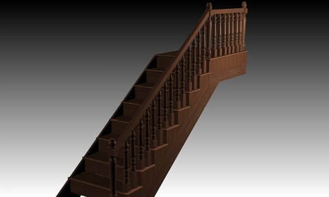

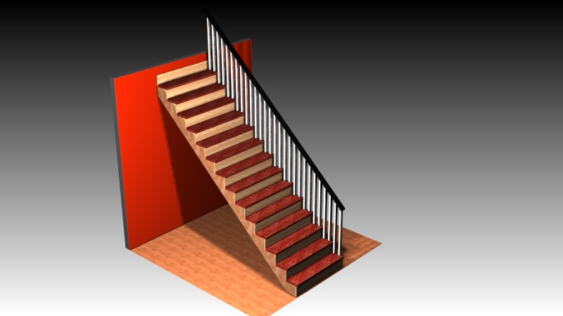

Stairs Plan
You will need to resizes them to what you want
