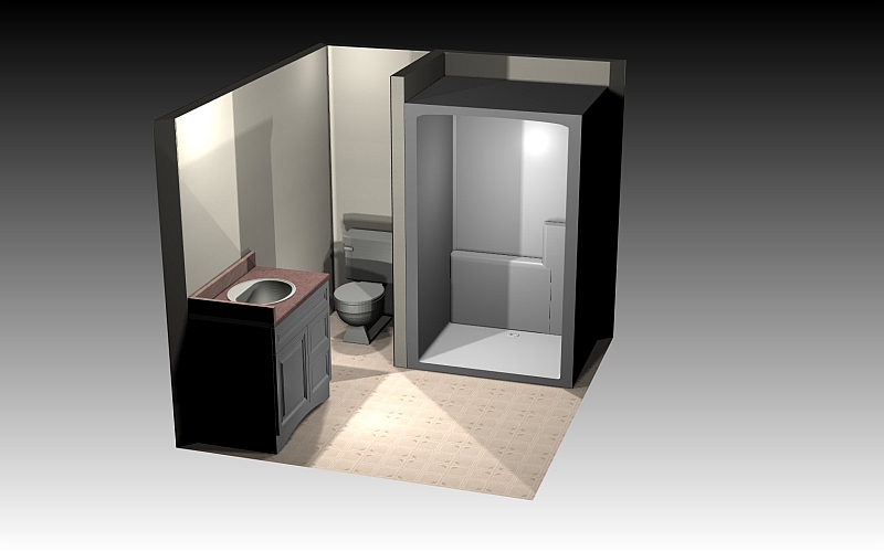

I am have a problem with the color white coming out white in a rendering. Has anyone else had this problem?
Scott G Vaal
Re: Problem with Rederings
Post by Scott G Vaal »
Gary,
It would be best to give us an example picture of what you are seeing and the job you are working with.
Post by Gary Puckett »
Scott,
Here is the job and a picture. The Vanity, toilet, and the shower stall all schould be white.
Ipswich Rendering.zip
(440.27 KiB) Downloaded 1077 times

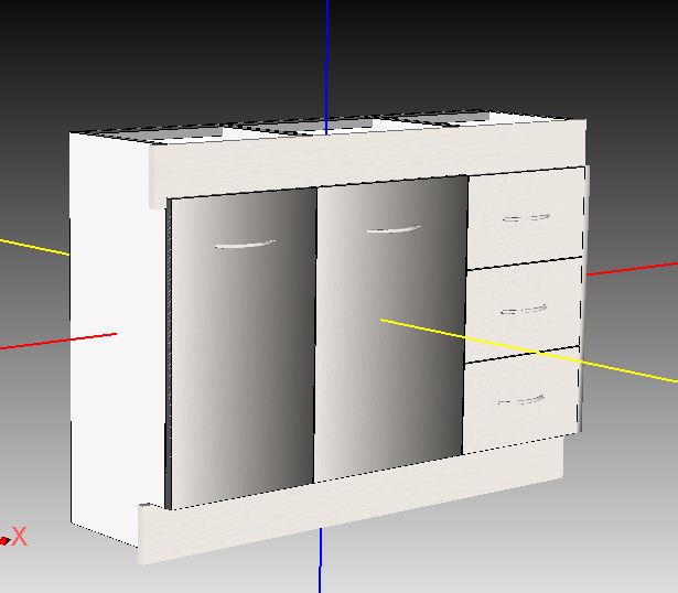

Here is one that it has happened to. It should be all white.
Nev Vanity.esa
(3.4 MiB) Downloaded 1125 times

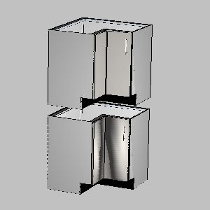

Hi guys
I found a trigger to cause this effect
To recreate this problem I take this corner unit into the door editor,
Highlight both doors.
Select the hole pattern for the hinge cup.
Select a new pattern.
Choose yes to accept to apply to selected doors.
When I return to the Main the colour changes.
(I had a little play with a base cabinet and it definitely seems to be the hinge cup pattern that causes it)
Hope this is useful.
Coloured corner doors.esa
(1.06 MiB) Downloaded 1113 times
Coloured corner doors.jpg (10.12 KiB) Viewed 13588 times
