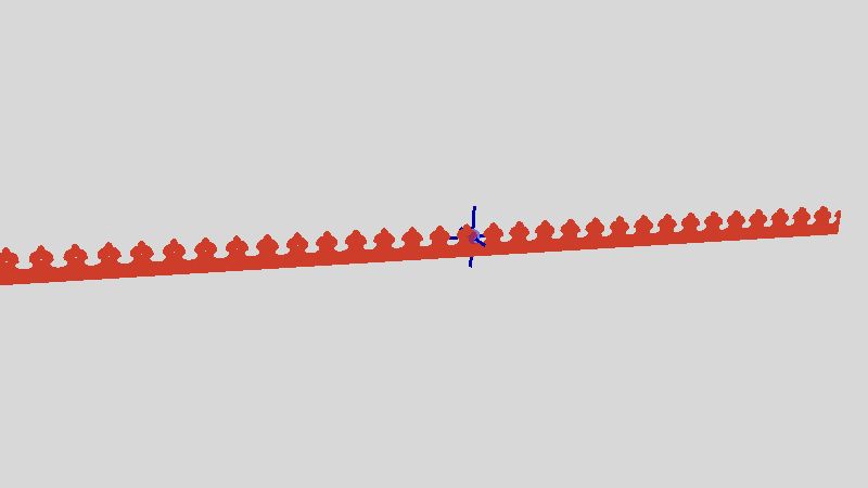

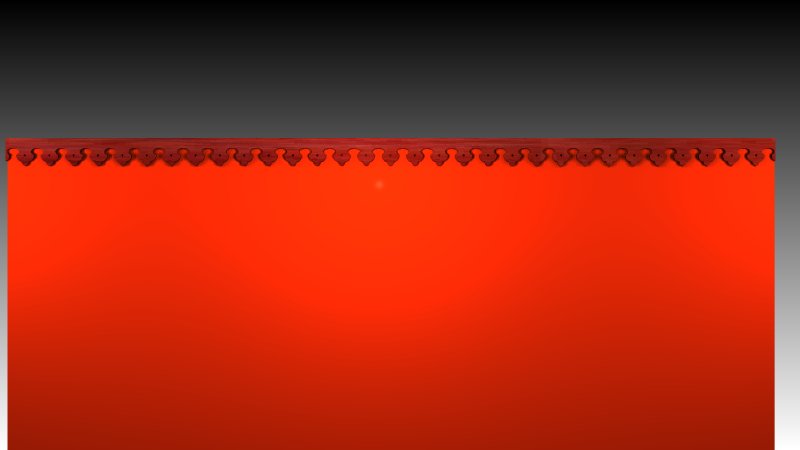

Hey Kerry, I managed to get the part into part editor and can cut out the holes, but for the life of me, I cannot get the fancy pattern to cut out. Did you get past this? If so how? I've left the computer running for long periods and it does not seem to help. Thanks. Jason

I had the same results. I was able to cut the holes, but when "creating the part using a closed contour" the "next" button would come up, but the closed contour wouldn't turn green and when clicking the next button, nothing would happen.

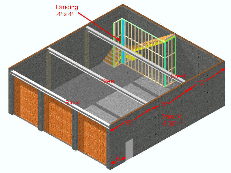

But you can not open it till someone helps me I need to size a steel I-Baem it has to be 40' Ft long it will have to holed two floor on top of it

The dxf's that you posted have polylines and light weight polylines in them. These will get converted into many small lines and creates unnecessary overhead. We recommend that dxf files only contain lines and arc/circles. I have loaded your dxf files into another cad software that we use that converts these polylines into arcs. I have attached them here for you to use (there is a metric and imperial version of the 2 files you posted). I also attached a cabinet that I cut this pattern into if you want it for review.
