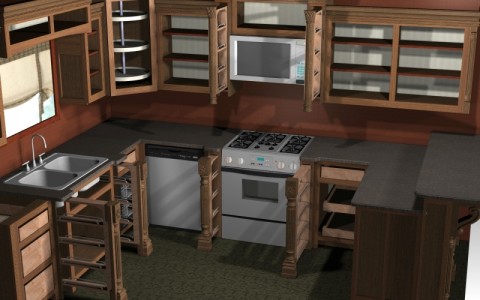

You can add the hardware items to the Cabinet buy list if you just want them listed in a bill of materials or you can use 3D models of them and add them as Hardware Objects and have them in the bill of materials and show them graphically as well.
That is what I have done with the hardware in this job.

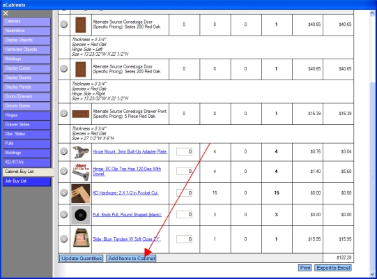

If I add them to the buy list they don't save with the cabinet, were trying to use ecabs for pricing our jobs and were getting there,
I can only add Hardware like Hinges or Handles that save with the cabinet

When you open your cabinet in the Cabinet editor you must first double click the cabinet to select it then add the items to the cabinet buy list. Make sure you use the Add Items to Cabinet at the bottom of the buy list not the Add Items to Assembly button at the top of the screen.

Thankjs Kerry
i didn't ralise I had to Highlight the cabinet
