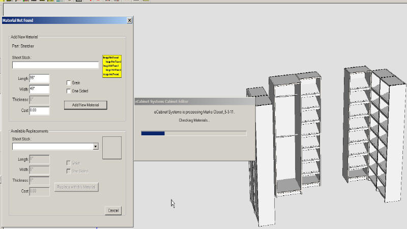

I made this closet up last night now it will not open :fire:

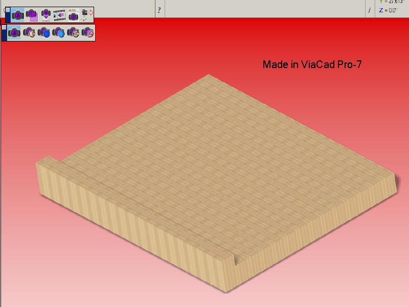

Shelfs are shoe racks tilled I made them 19"x 2" x 14" and cut them down to 3/4" shelf and the front is 2" x 1" I set up materials for it.It was all made from
ESL4766-3 Closet System (NO DXF Files) I made the shelf up in ViaCad to show how the it was cut in e-Cab

Re: Need help opening a Assembly
Post by Scott G Vaal »
George,
Here is a fixed version of your assembly (had to have a programmer go behind the scenes to fix it). Does it look like what you ended up with at the last save? Not sure what went wrong here, but it would be nice to know how you got it to this point. It showed that there were 8 cabinets in existence, but one of them was badly goofed up. Do you know if you had 8 cabs in here, or did you only have 7 that you know of? Can you remember the steps you went about to create this assembly?
Marks Closet_5-3-11-fixed.esa
(2.97 MiB) Downloaded 376 times
Thank You Scott
I will open it in about 4 Hr's
I am going to size a Kitchen up at 12:30
There was 7 cabinets I did make the shoe rack up and cope and past 5 of them
Thank You
