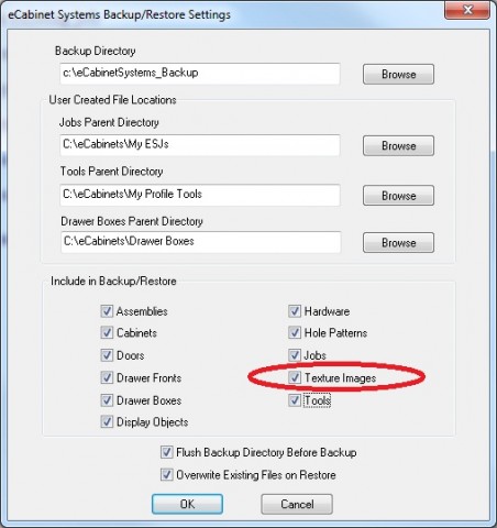

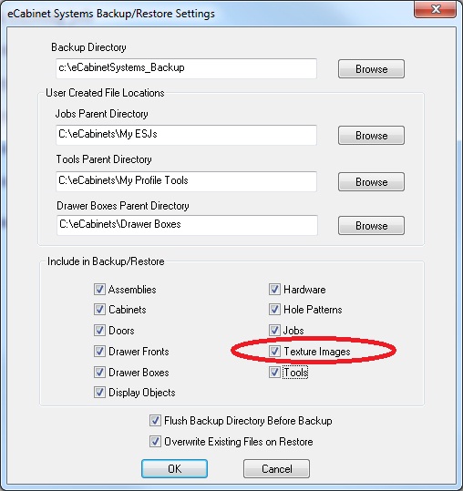

Did you have {Texture Images} checked to be on when you did your backup on your existing PC, and also, did you have it checked to be on when you did the restore on the new PC. If you did and you still have this trouble, please let me know what operating system you are running. These texture images can also be manually copied to the new PC by copying the folder:

Thanks Scott, yes I did have both of those checked. However, I neglected to say that the laptop is running W7 & the Desktop is running XP. I'm assuming the different operating systems was the culprit? Your solution to manually copy the images worked, and all is well. Thanks for your help.
