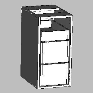

I've attached a cabinet file along with a couple of dbx files.
The problem I'm having is that when I add the attached 9" dbx to the cabinet, the dbx's PE cuts are going away (the cabinets PE cuts are not effected).
When I add the 4" dbx the dbx's PE cuts are staying in place (again, cabinet PE cuts are not effected).
Any ideas would be greatly appreciated. TIA!

Donald,
Took me a few minutes of scratching my head, but I have finally figured out why your 4" box had holes and the 9" did not. Your 9" box was saved at 22" deep and the 4" was saved at 20" deep ( 20" is the size needed for the depth of the cabinet). So, when the 9" box gets re-sized to 20" deep, it moves the holes off of the part because they are not constrained thus looking like they are lost (which they kinda are). Also, I did find some troubles with the 9" box that required removing the PE cuts and adding them back on. I have attached both boxes with constraints added and your cab with them installed. Hope this gets you going.
