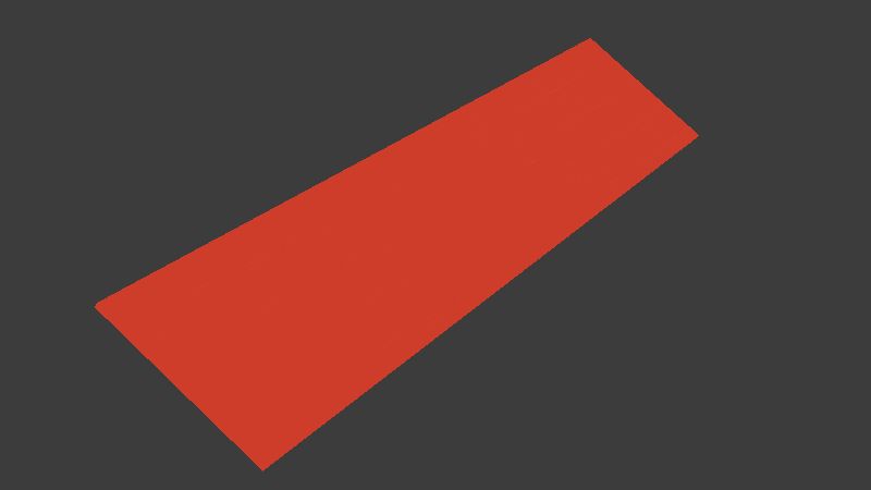

I am playing with an idea for a Hold Down Fixture for parts while carving, fluting, profiling etc.
This fixture will be 24"X120"X5/8" melamine. I will machine grooves to accept gasket material. I will use the machine vacuum to hold the fixture in place and either drill through the fixture (and plug as needed) and the table board to get vacuum for my parts or I will use the machine vacuum to hold the fixture and use a venturi pump to vacuum the parts.
The fixture will be positioned using the pop up pins and parts can either be positioned by the pins and I will also have a 1/4" square that I can add to the fixture top to position parts and use a fixture offset.
This should work for a variety of parts.
any suggestions?

I noticed the jpg eCabinets produced in the Cabinet Editor did not have any detail.

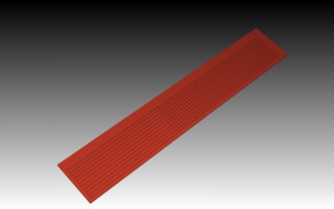

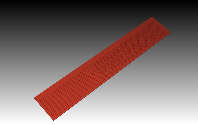

Here is another picture of the fixture.

Hi Kerry,
Looks like you don't have any holes in the fixture to let the vacuum through - or maybe the detail is just not showing up.
I would recommend the holes or at least one hole in the middle, and maybe some edgebanding on the edges of the fixture if you plan to use it a lot. This just increases the durability of the positioning edges compared to the MDF edges, with say a 1mm PVC banding maybe...?

I haven't put holes in the fixture yet as I haven't decided on exact locations.
I will probably try to go the Venturi route because I don't own the machine and Keith might not like me drilling holes through his table board and I know the venturi/s will give excellent hold down.
I haven't finished the fixture in the picture because all the part editor cuts have slowed eCabinets to a crawl. It takes about five minutes for the part editor to profile each groove now. Gets very boring as I am only about half way done.
I want this fixture for cutting multiple parts (mostly fluting and panel cuts of long pieces) The double stick is just too time consuming for multiples.
Would you put this fixture over the 1/4" wasteboard or remove the wasteboard and place it on the table board?
If I drill through the table board for fixture vacuum I was planing to cut a 1/4" melamine to cover the rest of the table for better suction.
I was just thinking one benefit of drilling through the table board is that if you have an odd shaped piece you could just drill another hole to accommodate that piece and plug it later.

Hi Kerry,
No, I would not drill through the spoilboard. I would drill through the fixture though, somewhere towards the middle of what you think will be the most central location, depending of course on what types / sizes of parts you'll be machining. I would run it without a wasteboard.
I don't know what kind or size of vacuum you're working with, ours is an 18hp rotary vane. We pull lots of vacuum and have scraps of shower board (white one side hardboard, about 1/8" thick) that we piece together to cover up the rest of the spoilboard or wasteboard when machining smaller parts.
We haven't had much trouble, we've pretty much got it down to a science.
Feel free to give me a call and I can give you more info if you like.
