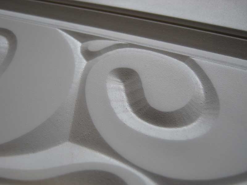

Will This smoothing feature smooth out the problem we have on this photo
Thanks Stephen

Stephen,
It may, you could start with a value of 30. Zero is OFF, 50 is default and typically highest recommended value. It will likely take a few test cuts on your part to see how the code will react specifically with the mechanics of your machine.
