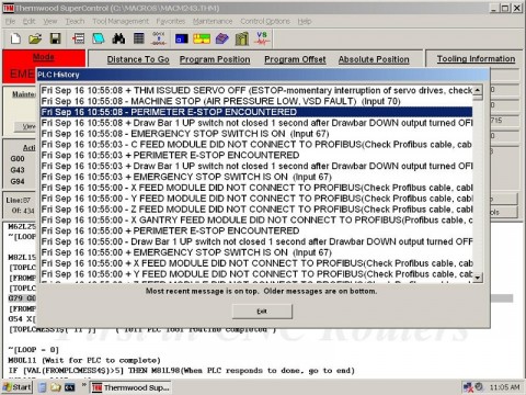

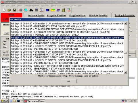

It happened again. I've attached a couple of print screens of the PLC history showing what's going through machine's mind. One is from the morning and the second happened just now.
