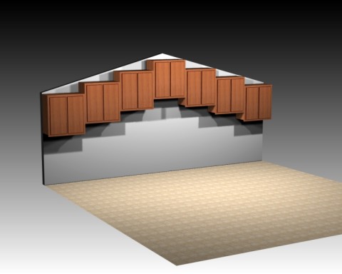

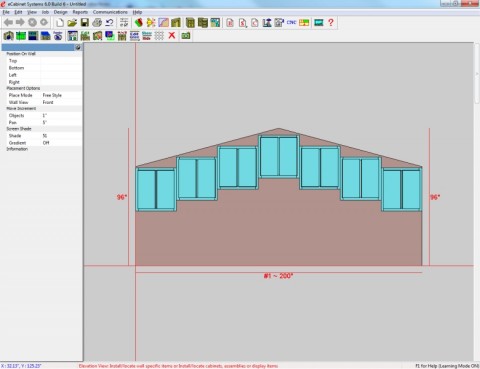

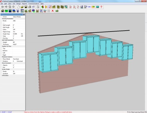

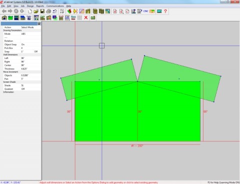

There is actually a way you can do this... You can create your wall the whole length needed, create filled rectangles in the Edit Wall View (starting the corners at the peak of the wall), then rotate them using the corner at the peak as the base point, then cut them from the wall (if you have trouble selecting the rectangle by clicking, drag a red selection box on it to get it selected). You will see a solid black line across the top in Overhead/Main View, but this line will not show up in Wall, Render, or Presentation Views. see attached pictures.
