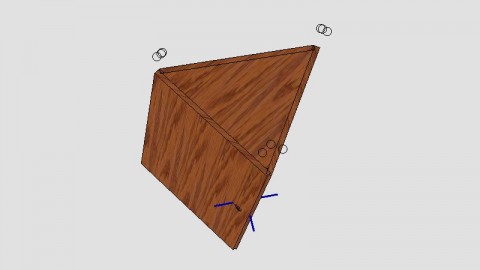

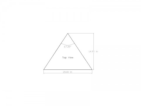

Is there any way to do a pie shaped lower cabinet with less than 90degree angle? We have a number of these to do and I can't seem to figure a way to do them. Front of the box is the 20" leg.

Re: pie shape lower
Fred,
Is this what you are looking for. I will have to play with it a bit more to get your exact measurements.

Re: pie shape lower
Kerry that is it. Measurements above are not necessarily what I need. I'm mostly just trying to figure out how you did that. We get all different measurements and right now in the dark ages esentially making on table saw.

Re: pie shape lower
Fred,
I have attached the cabinet I was playing with for you to look at. I am not sure it will work though. I had to use a display panel for the back so it won't automatically re-size.
I will keep playing with it.

Re: pie shape lower
Kerry, is there any way to use a back in place of the display panel?

Re: pie shape lower
John,
This was done using a corner cabinet and with the three piece back I can't get it to work. The center back is just a bit short to make the cuts.
I am going to try this using a miter fold.

Re: pie shape lower
Kerry,
That is it. I still need to get my head around the corner cab numbers and what all changes. Display panel is not a problem.
Fred
