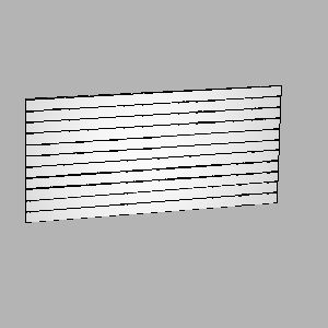

Hi Heath
I had a play with this and created a back and applied some part editor cuts with a mockup slatwall cutter.
It is a 2400mm x 1200mm with 100mm spacing
I have not applied any constraints
I found I could resize the width no problem and height.
If you make the height smaller then larger you loose the cuts. So you just need to reload the original back.
Don't machine this part from my mockup but I think you could set it up fairly easily.
See how you go.
Mark

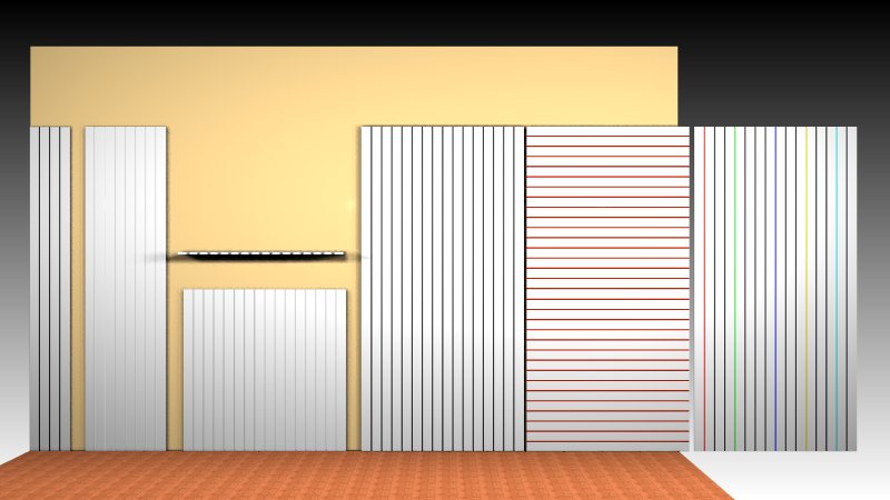

Hello all
I have different bead board in my display objects that I got from the 3D files. It has been there for quite a while and you can scale it. I would post it if I knew how, but you should be able to get it if you search for bead board in the 3D files. Thank you to whoever made it.
Greg Whitman
Re: Slatwall On Back Of Cabinet
Slatwall_.75_3in_Sheet of White
Resize
Slatwall_.75_3iin_Sheet of White.esj
(64.02 KiB) Downloaded 2135 times

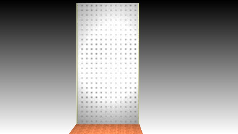

Or save money do it in PegBoard
PegBoard_4Ft x 8Ft.esj
(4.82 MiB) Downloaded 2247 times

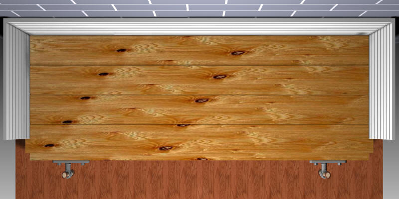

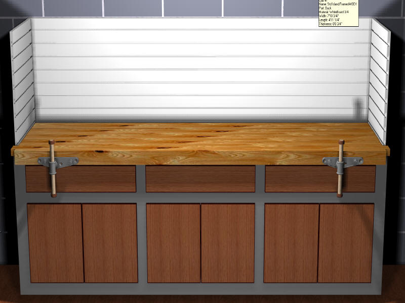

1-Base Cabinet truned into WorkBench.
Back and Sides are made into slatwall
WorkBench 8Ft x 34.5 x 24 B.esa
(4.84 MiB) Downloaded 2140 times
