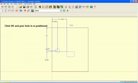

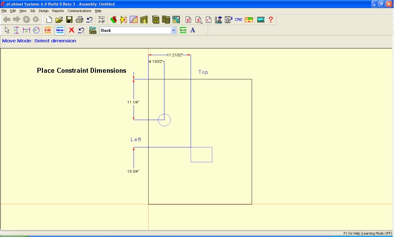

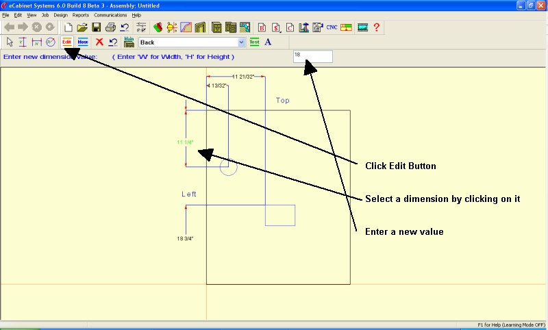

Re: how To Scale/Move Rectangles/Circles in Part Editor?
Tom,
You create the holes etc. the size you want them and cut them out in the part editor and then return to the cabinet editor keeping the changes to your part. You then highlight that part and take it into the Constraint Manager. You apply vertical and horizontal constraints to, say the center of a circle you have cut and then click the edit button and next click on one of the constraints you have placed. You can now enter a new dimension. Using this method you can change position of any cutout.

Tom,
First of all, eCabinet Systems software is not graphic design and modeling software. It is not CAD software. It is cabinet design and manufacturing software. It's sole purpose is to design cabinets and relay information to a Thermwood router to be cut. It does this very well.
If you want to use eCabinets then forget that you ever used any other software and learn eCabinets. I can guarantee that it will design and execute just about any cabinet that you can dream up.
Tell me what Cabinet Design and Manufacturing software packages you have used?
Now to address your first question, I would enter coordinates and place holes and cutouts correctly when I draw them in the part editor but if you don't do that then move them in the constraint manager. You just have to enter new dimensions and you are done. What could be easier?
I would strongly suggest that you subscribe to the training videos and by all means purchase the Almost Complete Guide to eCabinet Systems Software.
Learn eCabinet Systems Software instead of wishing it were some other software.
You stated that unless eCabinets changes you will not be using it. That is fine but be prepared to pay a minimum of $20,000 for a seat of any software that can compare to eCabinets.
Pardon me for being frank but you don't know enough about eCabinets to be criticizing it.
Call me at 806-333-2730 if you would like to discuss this.

Yes those tools are available in eCabinets. The eCabinets programmers have kept the tools very simple while still providing the the features needed to build cabinets. These tools meet the needs of a cabinet shop but of course are not adequate for a graphic design artist. To provide the tools Tom is wanting would make the learning curve much steeper and would most likely bloat the program as well.

The particular example of using the pick box to highlight the rectangle or circle to cut a hole and being able to move and scale it by dragging on it is much easier and quicker than the process you were kind enough to provide.Kerry Fullington wrote:Scott,
