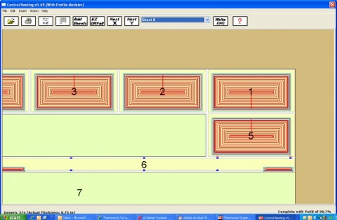

These are some adjustable shelves that I did a through pocket cut (using Closed Contour) in the eCabinets part editor.
I want to cut them out, not turn them to dust.
I have tried changing the Pocket Area (Through Cuts) setting in Control Nesting (down to 1^2) but it still wants to make dust out of the centers.
What am I setting wrong?

Kerry, after looking into file it seems you are wanting to cut a lip, maybe for a glass shelf....Control nesting does not support this type of cut yet...It should see a pocket cut inside a pocket cut, but as of right now it is wanting to pocket the whole area to the .25 lip depth and then do a through cut ...it should cut correctly but with the unnecessary full pocket routine.

I am going to use Josh's suggestion and pocket the center then use a profile to cut my rebate.

I hope you got it cut , Kerry. What I do there is make the thro cut as 1 pocket, then offset the rebate .1mm out from it. Works fine.
