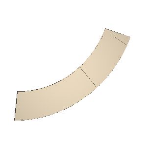

I have a chance to cut library shelving for a room with a concave wall. The radius is about 15'. Cabinets are 12" deep. The attached 2 minute drawing shows the basic idea. Is it possible to do this in eCabinets? I'd like to take advantage of the joinery possible in eCabs and cut it on the router. I thought about just using dxf drawings of each part but that would take a lot of time and result in a number of mistakes. Has anyone done this and be willing to offer some tips?

I wouldn't try to design it in ecabs, but I'd definitely use a cad program to get dimensions and then use part editor in ecabs, by either importing the .DXF's from the cad Program or just using the abilities of the part editor. Others here would be able to do it all through ecabs.

The parts can be done in eCabinets but I think the joinery would have to be drawn manually just like you would do in Cad. You only have to draw the joinery one time and it could then be applied to different parts.

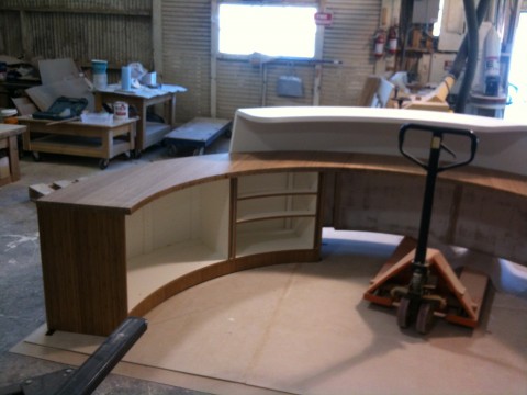

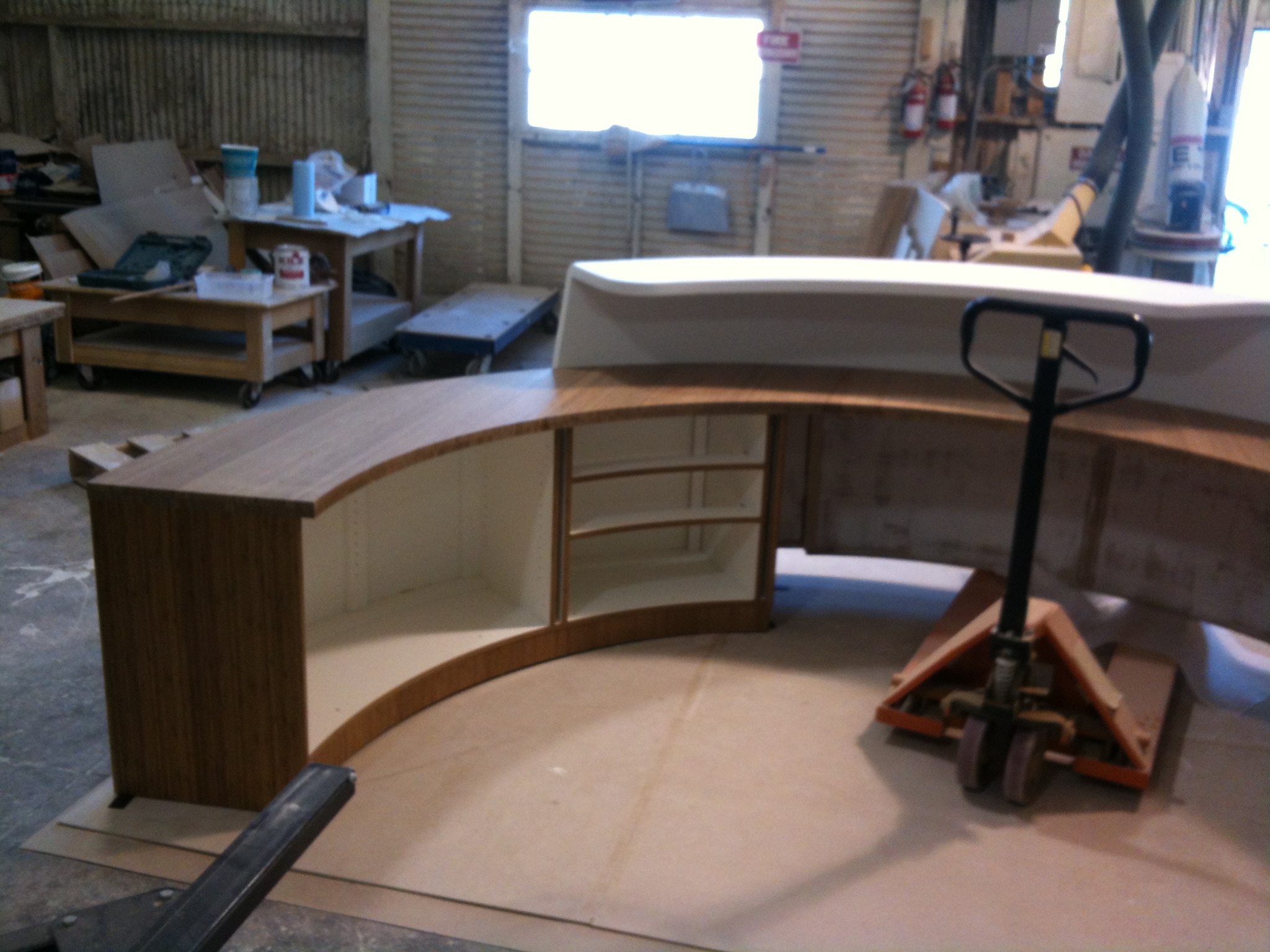

You just have to figure out your deck and top using .dxf files for partition dadoes. I am knee deep into this reception desk now and will post pictures of the completed project next week. Many, many hours of eCabinets planning and cutting!
